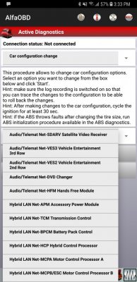

Daytime Running Lights CSM
Did they update the drop down menu's or something because I can't seem to locate this option at all and wanted to add it to the 8.4 radio under settings.
I am under the body computer > My2013-17 Powernet > Car Configuration changes > and I cant seem to locate the option to display it on the radio. I did see all the other options and enabled them and they are working but wanted to put on the radio as well since I am going to do it for my brother and a friend so they have the ability to shut them off if they want to.
I think the CSMs are towards the end of the list.

Yea even scrolling through the massive list I still dont see them... not sure if Im blind but no CSM or any Daytime Running light mention that I can find..
Looking at that screenshot, it will say exactly this- “CustSetMenu 1- Daytime Running Lights CSM”.
Seems I don't have those options at all in the drop down. I have scrolled line by line through it 10x now I have like Battery, VehCongif # 1-6, bunch of CBC I/O, normal CBC features, ECUConfig 3 options, Wireless, Doors, LIN to name a few but nothing at all CustSetMenu
