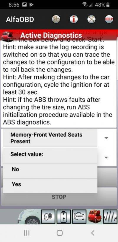

Yes if you have factory heated seats the vented seats will work plug and play if as long as you have the 8.4 radio and you enable the correct codes. They will work exactly as factory and the options will also be present in your screen. These are the codes to set. The first two are to activate the vented seats. The last one is the CSM setting. It will have the heated/vented auto on comfort menu on the screen select the 2-3 option.b472185be9276059a15a7dc33c48eca0.jpg01b4a480f399605e55a926121f8a9d6a.jpg6c909f426bcecdb22776d43f65efa6db.jpg
What do i select on the last menu? Feature 1-2 option or Feature 2- 3 option? Also will the memory settings work for the seat and will the passenger seat now be a power seat, if both of those do work do i need to turn anything else on?
Thank you for the help
As stated select the 2-3 option. You passenger side power seat is already pre wired. There are no codes needed to make the power adjust work. Some trucks that have factory heated seats are pre wired for the memory seats and some aren't. If your truck is pre wired you will be able to make the memory functions work by enabling the memory codes. I reccomend going to the first page of this thread and reading all of the information and reviewing all of the known working codes. There are directions for the correct codes to enable for the memory seats/mirrors. If you want the memory mirror function to work you will need to purchase memory capable mirrors. If you posts picture of the wiring going into your trucks driver's side yellow seat plug I will be able to tell you if you have the wiring for the memory seats.

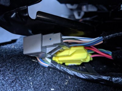

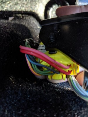

Your truck does not appear to be be wired for the memory seats. You would have pin# 5 white with light blue stripe pin#6 Solid white pin#2 violet with yellow stripe and pin#13 violet with brown stripe. My truck had non of the heated/vented or memory wiring and added it all. There is a thread on this in the 4th gen DIY section
(Adding heated/vented seats and heated wheel to Tradesman/Express) that I posted. I reccomend you ask questions there. Once you get your seats installed you can add the memory wiring later and enable the codes if you chose. It's not difficult to do.
