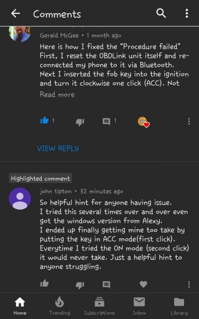

Couple of hints then that might help in your guys's Conquest.
Sent from my LG-LS995 using Tapatalk
So I did the premium cluster swap two weeks ago and I was able to get the idle and engine hours to update only with the ignition set to ACC. It failed and did not update with the key set to RUN.
I was able to adjust the odometer on the first attempt even though alfaobd said the procedure failed. This was with the key set to the RUN position.
