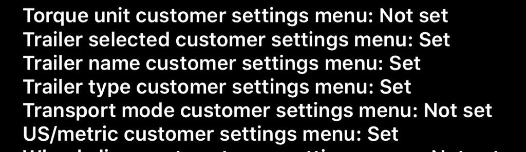

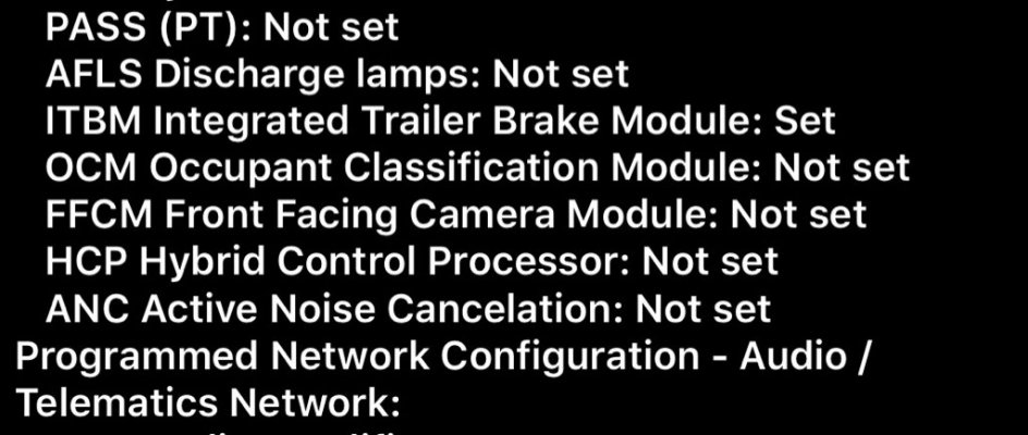

Hello, I installed a trailer brake controller last night, and went through the settings in alpha OBD. I have the EVIC working, But I am not getting settings on the radio. I have cycled the truck several times and drove around about 30 minutes this morning.
Here are the settings from my log file, it looks like the appropriate settings are enabled, is it just going to take time for this to show up on the radio?

So my radio settings are now working after 24 hours and several cycles of the truck. Patience is something I need more of[emoji4]
My radio took almost 2 days to change....what year and what radio model?

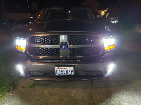

If i use alfaobd to set headlights to hid will i still need canbus compatible hid kit or will any standard kit work
On my 14 Sport with projectors I installed a standard setup (no can or cancellors) from hid kit pro's and have had no problems. Even put hikari leds in high beam and fogs, been working great :)78a7fa98be4d744a00f12f449e256179.jpg
