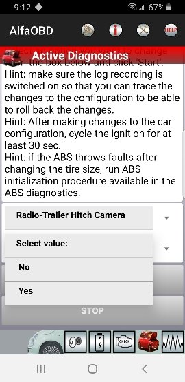

It's listed in the Body Computer section right after the CSM menu in the radio settings. Not sure which 8.4 radio you have but since your truck is an 18 I'm assuming you upgraded to the UAS/ UAQ radio so it should be capable of showing the soft key (Trailer Cam) icon in your apps screen. It will take the radio several key cycles to read the BCM after you enable the code so give it some time. This is a pic of the code in the Alfa tool. ed71a7822763d671b381cced7c99ea12.jpg

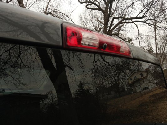

I just added the 2018 UAQ to my 2015 and used Alpha to turn on the cargo cam which I am using as the front camera and it works great. Once you do that you can use the on screen buttons once the camera is activated to toggle between the front and rear cameras. Until I turned on the cargo cam these buttons did not show on the screen. Which makes sense since there was only one camera the computer new about before. When in motion I can turn on the front camera at any time and it will stay on for 10 seconds (per the manual) before auto turn off which is what the cargo cam is programmed for and it can't be changed.
Only Gen 5's now come with a front camera (and other ones as well) therefore for us 4th Gen guys I HIGHLY recommend anyone that does not need/want the cargo camera to use it as a front camera instead. It makes parking much easier in my opinion and is just fun to view when driving for a few seconds. When stopped (but still in drive) you can toggle between the front AND rear cameras which is kind of nice if you think someone is getting to close to you from behind. This one: www.amazon.com/Crimestopper-CAM-400-Camera/dp/B078PLLN7F/ref=sr_1_fkmr1_1? is the one I got and it's very nice since it has 4 different mounts one of which is perfect for Rebel style grilles like the one I added.

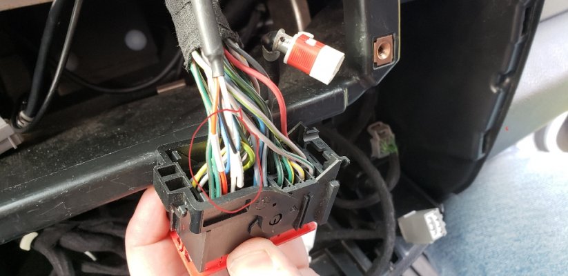

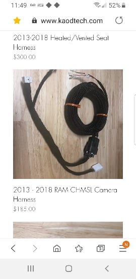

You can also buy the harness from Kaod Tech. (Deer Guy) and purchase the factory cargo cam third brake light separately and enable the codes with the Alfa tool. His harness connects into the back of the radio connector exactly like the factory. I used his harness. It fits perfect and it works great. I think he charges $185 for the harness and you can find the OEM CMSL for around $300 so might be a cheaper option with less clutter than the Infotainment setup that adds the extra harness between the radio and the truck. This is a pic of how his harness connects into the back of the radio connector in the factory location. Since your radio is out of a 2016 it won't try to divert your backup camera to the rear view mirror when you enable the cargo cam like the 13 to 15 radios do so you shouldn't have any issues. My radio is also out of a 16.

If all you want to do is add a camera, you can run the cables and mount a flush mount rearview camera really anywhere. Mine is in the third brake light. Then buy one of @Mpgrimm2 's front/cargo camera harnesses for $20 shipped. You should be able to do it all for $40...$50 if you add another camera and switch them manually when needed.
