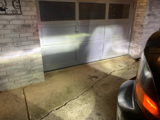

I just installed hikari led fog lights, 9006 size and they won’t come on at all.
2016 big horn. Vertical, halogen fogs came stock.
I have alpha obd and changed the fog light dropout to “NO” and selected “YES” to LED fog lights present. I have also selected “YES” to enable HID.
Is there another change I need to make?

Try unplugging the bulb and flipping the plug around.
I have same led and I didn't make any changes for it

That did it but man have I got some tuning to do before running these things...
Try running them at the 3 and 9 o'clock position
2018 Ram 2500 6.4L Hemi Tradesman
1500ram12 is right. Luckily the Hikaris are clockable and the foglights easily accessible. Just grab the fan housing on the back of the bulb and spin it until the power cord wire is at the 6 o'clock position (which should face the LEDs to 3 and 9 o'clock)...
Thanks, I’ll give it a shot. I’m waiting on an adjustment screw; I found one missing the other day and my fog lights were lighting up the tree tops.
A long toggle anchor bolt will do the trick. The factory adjustment nuts seem to shake off...
