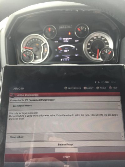

Ok, so it stopped changing mileage for you once you set it to zero right? So, I wonder what would happen if you drive it and let 1 mile rollover? Then try to program it again, maybe it's hung up?
Just keep track of things manually so you can program an accurate odometer reading. You can watch the trip meter to see if it's tracking mileage properly on your short drive.
Took it for one lap around the block, rolled over to 1mi. Tried to then reset it to 100911 miles, but nothing. It stayed at 1.

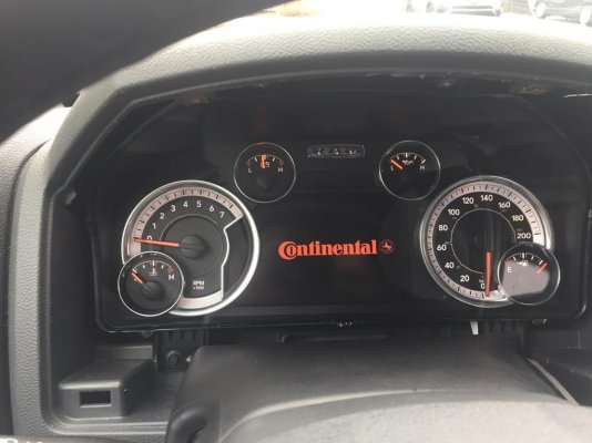

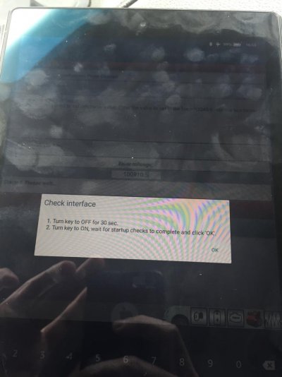

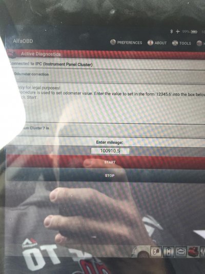

Here are the steps I took on my last attempt. Let me know y’all can see something I did wrong
Try doing only 1 click and don't turn it on and off when it asks (just hit ok). If you haven't updated ALFAOBD today, try that too
Tried the one-click and two clicks, pressing ok at the requested time and without turning the car off. I even tried today in a big parking lot to see if maybe I was getting some Bluetooth interference.
No luck.
Weird thing, when I switched the old cluster back in the mileage was what it should be but I got an alert saying that I had traveled 32000km since my last oil change. So some info is transferring but not all of it.
No luck.
Ok, last thing I can think of to try is unpair your OBDLINK MX from your phone completely and un-install the AlfaOBD app. Then reinstall the app and re-pair the OBDLink. When you first open your AlfaOBD App, make sure you set the OBDLINK MX as the default when it prompts.
Finally, if your phone connects to any other Bluetooth devices, make sure they are off or out of range/not connected (like a car radio Bluetooth connection or headphones). You can unpair those as well if you have difficulty keeping them from connecting.
