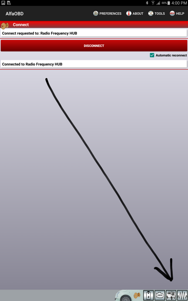

So I had to program a new fob for my 2016 Ram 1500, and after much research I wanted to share my steps that led to success. Hope it helps someone out there.
THIS IS FOR THE FOBs THAT USE PUSH BUTTON STARTER, not the ones you insert into the ignition. I believe "Lawsuit11's" post is the one you wanna follow if you have that kind of FOB.
1) Obtain your 4 digit pin from your dealer (mine charged me $25). If they ask why you need it, tell them that your locksmith is asking for it.
2) Push the ignition button to ACC
3) Open the AlfaOBD app, and connect to the OBD MX or MX+ interface (mine is bluetooth)
4) Select RAM and select your vehicle (in my case 1500)
5) Select RF Hub
full
6) Once you connect to your RF HUB, look at the bottom of the screen, where you find the little car with the open hood icon. Click on that.
