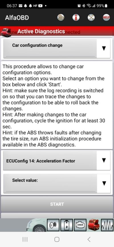

Not sure if this has been said but if you want to emulate what a pedal commander does change two settings in AlfaOBD:
ECUConfig14 /Acceleration Threshold: Filter Off
ECUConfig14 /Acceleration Factor: Filter Off
This made a huge difference in my throttle response. I've seen a few people debating whether it actually does anything but I can confirm that if you set it to those settings you will feel a difference in throttle.

Where do I find this in AlfaOBD to check if it is on or off?
Thanks in advance

Found these on my 2017 but there is only ECUonfig4 on my 2013.

Placebo effect. Those settings can’t possibly change the sensitivity of the throttle pedal (controlled by PCM, not BCM).
ECUConfig 14 deals strictly with the BCM configuration for the occupant restraint control module (it’s gyro and accelerometer, etc).

I can 100% tell you it is not a placebo there was a noticeable change in my throttle response. There used to be a slow ramp regardless of pedal position. Now it's much more responsive. There is also a setting in there that deals with brake smoothing and steering smoothing under the same Configuration. That effects the brake and steering wheel as well.

Could they be called something else on the 2013 truck? Even searching by name, nothing comes up.
Potentially, but they just may not be there in that truck. I would try things like looking up factor or smoothing. Brake smoothing is in the same category so if you find that you may find acceleration
EDIT: Just looked through the 2013 BCM module and it doesn't appear functionality is there for that.
