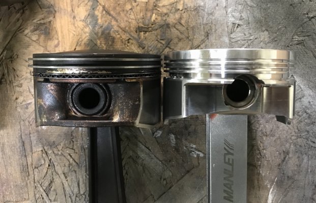

I’m not boosted, but just throwing this out there. The guy that does my tuning has a 10.5 compression motor and is running ~15lbs of boost haha. The problem with the stock Hemi internals in the top ring land on the piston, it’s pretty small. And the ring gaps from the factory are too small for big boost. Here’s a factory piston next to the upgraded forged Manley piston that’s in my truck now.

No no not stock motor, it’s a forged stroker. I’m just saying he’s running a high compression boosted Hemi. It’s not the compression *as much* as it’s the ring lands that’s the problem with the stock motors
