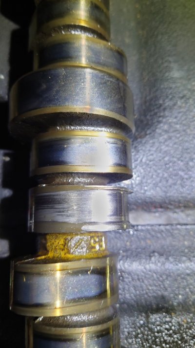

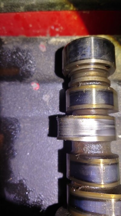

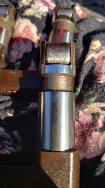

Well... I'm glad I went ahead and tore down. Found one lifter that was completely done and two others on the way out. Cam is toast as well.

Well It seems like I just cant win. I ended up replacing the timing chain and crank shaft gear along with the guides. Replaced the oil pump with melling HV. Replaced the camshaft with OEM and lubed it when I installed it. Lubed the lifters and put the engine to together. Rotated the engine a few times to make sure everything felt good. No tough spots or anything. Engine felt smooth. Got everything back together and its first start time. Removed the fuel pump fuse so I could crank and prime the engine. Everything seems fine, cranking has a slight gallop to it but oil pressure comes up. Dont think about it and replace the fuse. Engine starts with out a hitch and sounds good no ticking. Let it run for awhile to get up to temp. A few minutes in I start to hear ticking again and its worse. Seems like its coming from both sides now. Sounds like valve train noise and not rod knock. Give it some rpm noise seems better and oil pressure looks great. Idle down and noise is still there. Shut down the truck and pull codes. Got a misfire on 4.
Guess Im pulling the valve covers to see if anything looks off. Used some 5w-30 and STP for the first run before I change it. The only thing I can think of is that I may have gotten a bad set of lifters. I probably should have went with my first instinct and got another set. The set I used were ultra power from rockauto. Nothing seemed bad about them, I tend to over think things some times so I used them anyway. Going to do some poking around this afternoon probably remove the intake and valve cover for a start. May use a scope to look inside the cylinders. Wish me luck guys. I could really use it right now.

Update. Truck is back to together and running smooth. Come to find out the cheap set of lifters were the issue, imagine that. Had alot of shipping issues with the OEM lifters being sent to me and loose in box thus causing damage, but its done. If anyone reads this just go with the OEM lifters. Its not worth the trouble for a cheaper set.

Don't worry,you're not the first guy who's been bit in the a$$ using cheap lifters,Engine Tech and TSP lifters are also famous for giving issues.If at all possible always use OEM lifters,even if you have to wait a week or 2 to get them
