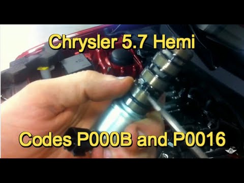

Did you see the condition of the oil control valve? It either has metal or it doesnt. If it does, mise well play around no downside to anything. But if the tick is new and the oil control valve is clean, there can be some risk with metal in engine. Then you need to weigh the decision, lubrication strategy or cam swap Even if you do a cam swap, you still can go to a lubrication strategy to protect the cam for the next time. You seam to have a lot of talent around an engine, so maybe you go that way, your choice.

This guy is the best resource that I know.. If that valve has metal all over it then Ram says the engine is unsaveable, warranty or not. So no reason not to play around if that has metal on it, I didnt check how long you were driving with a tick.

Pulling the ocv was on my list of things to do. Unfortunately with the egr cooler is in the way so its not as easy to pull as it is on the 5.7. So I figured inspecting the filter would do the trick. Correct me if Im wrong. Does the the ofc get the pressured oil before the oil filter. Its the only reason I would think to check the ocv before the filter.
