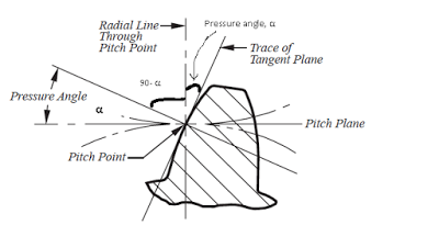

Marking with grease will just show you the gear mesh pattern. Why don't you want to use a drop/dial indicator? You can get one from HF or amazon for like $10 if you want to go cheap with it. I have calibrated those cheap ones before and they really aren't bad.
I suppose you could use a protractor and do the math for rotation based on the pitch/pressure angle of the gears. For gear inspection purposes I have done this in the past. But it would be way easier to use an indicator.
