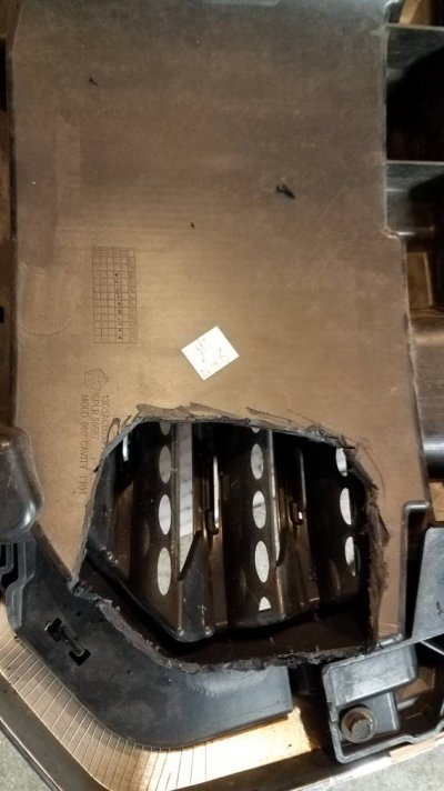

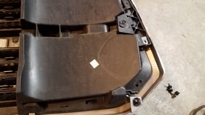

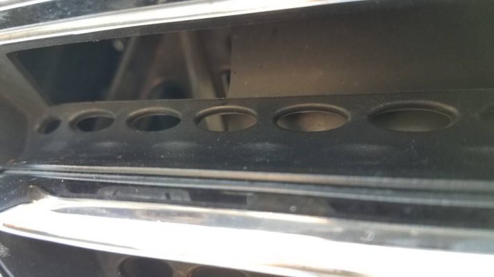

Trying another little free mod. The factory air intake gets it's air from the fender but there isn't a real good flow into that part of the fender except around the passenger headlight and from under the truck. I pulled the grill off and saw a spot I could cut a hole into that would feed it fresh air going down the road. The Cummins trucks take air from around the same spot. Pretty simple to make the cut with a Dremel. Yes I know my cuts suck but it won't be seen unless the grill comes off[emoji4] Keep in mind with the honeycomb grill this could be a LOT more obvious.
I'll post later if this actually helps with intake temps or not.1103d3c09602df0f9364eb60a00f2209.jpg64c62fc0e49018780686f1b5e2aef77b.jpg33d6c6874dad8be45842c7bf6c39ebee.jpg00474e7088fb4f16e972d5c5fcb75b4c.jpg

That's a great idea Hemi , definitely post up the results of the air temps and or fuel mileage change also the SOUND , If it's a deeper throaty sound when your in the pedal [emoji106]

The one nice thing of taking from well is there is little duct in there, will be interesting if this will make air filer more dirty.
I was thinking about this as well. I'll post about that too since pollen season is about to start here...

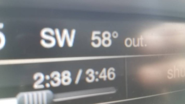

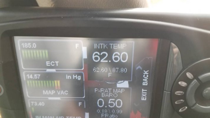

Well was not expecting this. Normally the intake temps with the stock intake hover around 8° above ambient temp. It usually takes a while driving to get down to that 8° above. With that hole cut in the grill backing it dropped much quicker and settled to about 4° above ambient temp. I honestly was expecting a degree or 2 cooler intake temps but not a 50% drop. The 62.60° reading on my Trinity kept dipping to 61.80° and then up to 62.60° so I figured 62 was a good middle ground. Pretty impressive. I'll update on if my air filter gets dirty quicker also.893561014d812b1032dfcac163f30b54.jpge9770f27409e53f9bcfba8b73e0340b4.jpg

More air, more dirt. But, sounds like a worth while upgrade, just replace the air filter a little sooner or make sure to check it every 6 mos or so? Knowing you I bet you check it more often then that already. So now you have a CAI but outside engine bay, and if I was to have a cai, that is what I'd prefer too. Never understood cai inside a hot engine bay.
