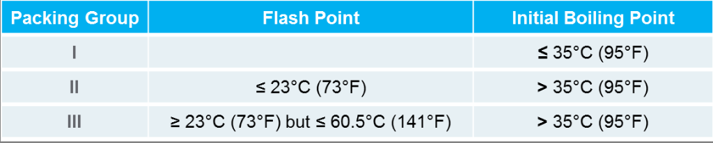

Basically DOT has a bunch of rules for transporting hazardous materials. Diesel and gas are both class 3 but gas requires a type II packing group.
Class 3 Flammable Liquids Packing Group
Tanks and pumps DOT approved for highway transportation of gasoline get expensive fast.
