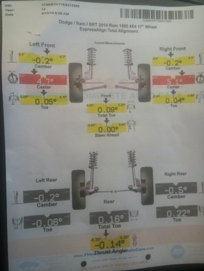

Here you go bud, don't mind the red values, that's is because caster is outside of the factory range. This alignment didn't rub with 37 KO2's at 2.75" lift
46685766935_5100061348_k.jpg2019-04-13_01-21-06 by RAM RSM, on Flickr
This one does in reverse turning, notice the caster differences. this is the lastest one i'm running from a couple months ago. Next time i go for an aligment i'll ask my dude to remember to up my caster. He's great as long as i'm there watching the job telling him what i want. In this case i left the truck in the shop, told him what i wanted an came back 2-3 hours later :), the difference is so tiny is funny, but this one makes my driver front 37 KO2 rub in reverse while turning driver. Cosmetic rub though.
48992573667_4b7a041220_k.jpgUntitled by RAM RSM, on Flickr
It doesn't have to be exact numbers so i'll give you the ranges:
Caster: 4.5* - 5.0* (min 4.7*-5.1* for 37's) you ain't getting here with the Mevotec stock arm UCA's, You want uca's with offset: JBA,Zone,Icon,RL etc, etc etc.
Camber: -0.2 - 0*
Toe: 0.10 total max
Have fun bro.

my truck has quite a bit of rake so I’d probably use the highest setting at 2.6. Do you know if I’d have to get new UCA’s like recommenced with the 5100’s at 2.8? Thanks
For any of the lift/leveling struts, whatever brand they all will have different ride character and damping but the way they affect geometry is the same on all of them because the front suspension movement isn't dependent on the strut, just where in its range of movement it rides.
It's possible to use factory UCA's at the highest setting but in the case of my truck (2.8") that put the alignment cams at their extreme ends to get the truck barely within spec. When I replaced those with aftermarket arms built for lift it allowed the alignment techs to put those cams in a more neutral position and align it to the middle of the specifications instead of just barely in the brackets. Call it a placebo but I think it feels better too so the extra cost was justified in my opinion.
The 6112's didn't exist yet when I put the lift on my Ram and I haven't felt like I'm missing anything with "just" the 5100s but we're all in different economic situations and we all have different demands and it's really hard to tell on the internet if any two people agree on what the right amount of anything is, might as well be arguing over mayo vs. miracle whip sometimes :)
