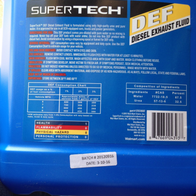

Supertech DEF
they don't try to hide the date, like BlueDEF does
Some people see the white powder on the jug & unscrew the lid to see if the seal is intact
Walmart Supertech shelves are often empty, so when i see it on the shelf, i grab 2 of the cleanest jugs
