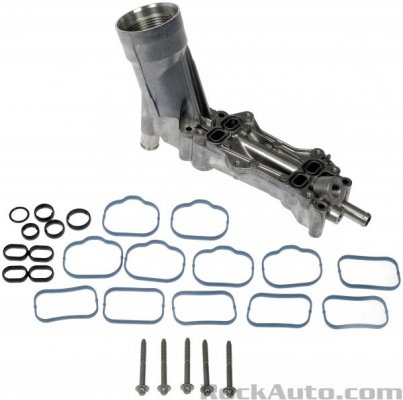

I would suggest going with the all aluminum version made by Dorman. No more plastic to crack.
RockAuto usually has the best price but currently they are out of stock. When I ordered one for my wife's 14 Chrysler 300 it was just a few days before it was back in stock and they shipped it out.
Watch out. A lot of other parts vendors are selling these at double what they should cost.

Yep. Go with the doorman all aluminum replacement if you can find one. As far as I know, they've been on back order for some time.
Very rare to have an oil leak any place else on a pentastar other than from the oil filter/cooler housing. Don't be fooled into thinking it's a valve cover or rear main seal. The oil will eventually fill the valley in the top of the block and run down the rear of the block and sort of look like a RMS leak.

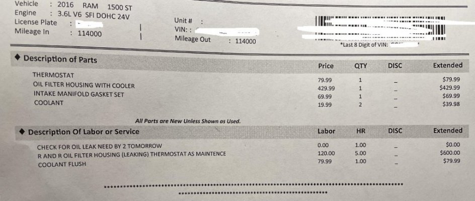

I finally had the chance to get the work done since I can't do it myself. (bad back). They said there was oil all in the valley of the engine. The new part is upgraded with a metal base so it won't break again the same way in another 100,000 miles.
They said they replace a lot of them on Pentastar engines right at 100,000 miles.
Labor was $600. I like this mechanic and have worked with them before, but does that labor amount seem excessive to anyone?

They charged you $429.00 for the assembly ? To me that seemd high !
They charged you for the cooler ? And gaskets ?
Dorman comes with all the gaskets for around $150.00 and they reuse the OEM Cooler as I heard you can not get the cooler by itself !
Labor $600.00 for 5 hours, Shops labor here are about 80/100$ a hour here but areas are different But the part charge to me seems high . Dorman is about $150.00 w/all gaskets ! But I may be missing something ! The Oil Cooler I thought you could not et by itself !

Yeah, iunno if I will go there again. The truck is paid for, so I had plenty of money to pay for it all, but it did seem steep.

429 list canadian wouldn't br horrible. I mean when you pay for parts at a shop there can be anywhere from 30 to 100 percent markup. You're paying for convenience and right ****** now parts.

Glad you got her fixed. Sorry it cost so much. Assuming they used OEM parts, I can tell you the OEM part has not been updated with a metal base, so they're blowing smoke up your **** there. It's the same plastic housing with an aluminum heat exchanger bolted in place.
As much as I try to do all the maintenance I can on my vehicles, I'm not sure I'd try this job myself. There's a lot that has to come out of the way. Many nuts, bolts, wire connectors, clips, fasteners and hoses that have to be undone to get at it. The guys that do this job day in and day out probably get it done in under an hour. $10/minute for the shop isn't too shabby especially when they double the price of the part and still charge you $10 for shop supplies. LOL
