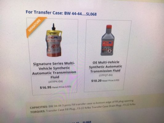

So, Tim. You're running the Amsoil in your 44-44 ?
Mine's a 2016, and it's supposed to use a different fluid, but the Amsoil site just says 44-44, doesn't specify year. Would you use it in a 2016?

Yes the red signature series ATF, word on the street is they changed clutch material and call for a special potion fluid after 2016. If you email Amsoil, they’ll let you know if any testing was done on the newer 44-44 Borg Warner.
I changed my TC oil to Redline C+ atf which is what they call for in the 2016, have not had to use 4wd so far this year but took it up in the snow last year and it seemed to work fine and the Redline is less than half the price of the Mopar stuff. I think amsoil on their site recommends their signature atf tor the 2016 44-44.
