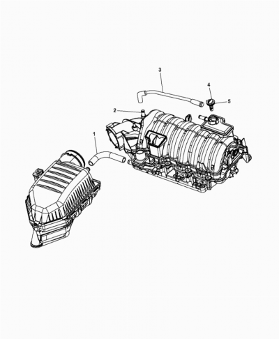

I found this on a Mopar Parts website. Apparently the 6.4 breather has a valve with a hose that comes from the engine oil fill tube over to the air intake hose.
@Nick@GotExhaust - you got anything for this?

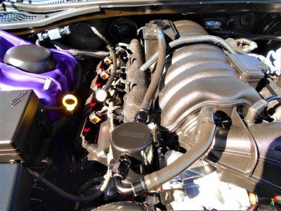

Wrong 6.4 intake,thats the car version,that one you can add a catch can to easily.Here's a pic of my wifes 6.4 Challengers Moroso can.The 6.4 truck intake is quite a bit differant

Ah geez - they posed it under "Ram" even though the pic isn't a Ram engine. Good catch, thanks. I guess there isn't one to bolt on to Ram Truck 6.4L.

I have spoken to a couple companies about making one and even did some ground work for them but i think the fact that no one has seen enough interest in them for the truck 6.4 to start spending the time and money to R&D it.
