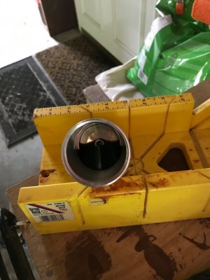

I have the UPR one. Excellent quality and fits perfect. Got it thru Nick at GotExhaust and he provided excellent service and speedy delivery. Only glitch was (not due to Nick) that he ordered it shipped direct from UPR and they included the wrong can. I had ordered the drain kit as well and the can they sent didn't have the threaded hole in the bottom for the drain valve. But Nick got on it and I had the right one a couple of days later. They even included the return shipping label so no hassle. Definitely recommend dealing with Nick.
This is what I collected during the first 600 miles. Probably a couple of tablespoons so definitely worth it.
IMHO though, if I had to do it again, I would skip the extra $35 for the drain kit. I never installed it since it was kind of a PITA to run the drain hose and, honestly, there is so much room to unscrew the can that it takes no time at all. Also, I've seen where people had some weird gunk collected in the can and it would plug the drain anyway. One thing too, putting the hoses on the connectors is a one-way street. Put the metal collar on BEFORE you push the hose on. You'll never get it off again. I did one without to test and now have one hose without the chrome collar. No biggie from the operation viewpoint, just looks crappy. Anyway, that's my 2 cents.
