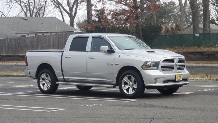

I am looking to buy a Ram 1500 around 2015-2018. I am in discussions with a seller. It is the sport trim with the black strips and 20" wheels. The contouring at the bottom looks to be lower than other trim levels - I could be totally wrong. I go offroad and pull trailers a lot so I would prefer a trim level that is not lower. Is this just perception or is there some contouring on this trim that brings it lower to the ground? Thx
I don't think they are any lower than any other Ram. Good looking truck, though.
