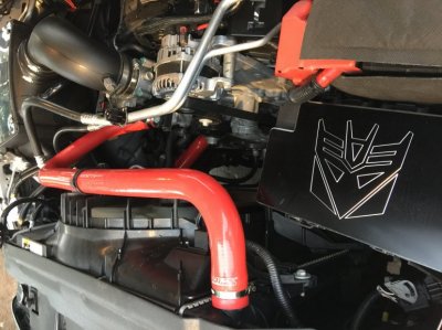

Order a oemmmopar fan you pay more but totally worth it.
