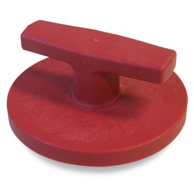

As many of you may already know. Since 2013 removing the oil filter on the cummins can make quite the mess. At first when we ran into these at my dealer it was kind of a nightmare. You could get around it by using a glove stretched over it or rags or something. Eventually people came out with the plugs to screw in the top, they work great. Some of our tool guys wanted anywhere from 15-30 bucks just for the plug. Being into 3D printing I told my lube techs save their money. So I ended up drawing up a design and printing them for my lube techs. Work great, and saved them some money. Just wanted to share with you guys.

Do you or would you share the .stl file for the cap?
Thanks in advance. I understand if you do not want to share it.

Thanks, I had one but seem to have misplaced it. I have a 3d printer was thinking I would like to try printing one. I may have to order a new one.

Hello I haven’t seen any updates on this issue so I wanted to ask, is this stl. File available and will/does it work for 2022 6.7 Cummings. All others I’ve seen online don’t support over year 2018
