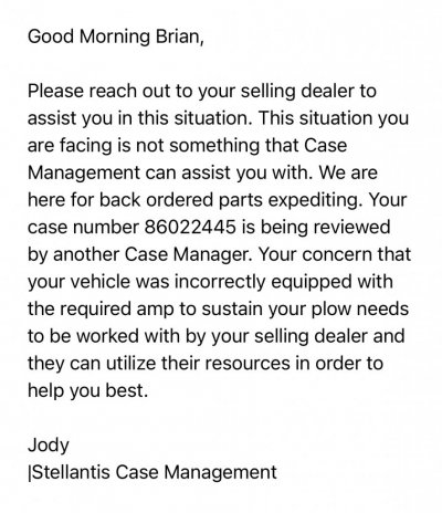

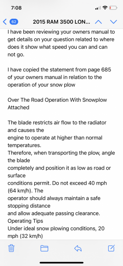

Let's see... signed up yesterday, one post that bashes RAM/Stellantis (sorry it hasn't been Chrysler for over a decade). Would you mind sharing the VIN ? Yeah, didn't think so. Are you using it as plow truck ? Yeah, didn't think so either.
Let's assume the truck was built without any of the plow prep upgrades, it should still not overheat in on-road use. If it did, the dealer should (and I realize I put a lot of faith into dealership "technicans") be able to figure out why that is happening.
Csuder99:
I have nothing to hide here!
My vin is: 3C63R3FJ2FG631932
Attached also is my window sticker
Of course I use it was a plow truck, but that doesn’t mean it should overheat.
If you wish to review the repair orders, I can supply those as well, but since Feb 24, with replaced the clutch fan, the thermostat, the radiator, and flushed the system.
Even after all of that, it is still overheating. Their next “official” response was “your plow is too big”, so I asked what size plow is allowed, but they had no answer. (FYI—-I have a Western WideOut on the truck).
Also attached is STELLANTIS response about the vehicle not being build with the correct parts
Also attached is some BS response from customer care, stating I shouldn’t drive over 45mph with a plow.
But that still doesn’t answer why it overheats even doing 25mph

Yeah, the snow prep package is nothing but a higher amp alternator - really doesn't explain any of your non-charging issues.

Ok, I apologize for thinking this was a troll post. In any case, the snow plow prep package for $85 is just the upgraded alternator. Looking at the build sheet (not the Monroney) it does list the snow plow prep but then below it is says 180A alternator which doesn't square up. It might be worthwhile looking for a part number or similar to determine which alternator is in there.
Regardless of the alternator being 180A or 220A you shouldn't have any charging or overheating issues. Trying to blame the issues on the alternator is not a winning proposition IMHO.
Have you tried a different dealer or independent diagnostic place ? Seeing the truck is running in the salt belt there might be issues with the wiring that cause things to go haywire.

I don't see a response about it being built with incorrect parts, just a response saying 'we're not the right department' and someone pointing out that your owner's manual says to stay below 40 mph with a plow on, which is just them covering their butts.
As for which alternator it was built with, you've got to get ahold of an actual build sheet, not the window sticker - The 6.4 MDS engine put the minimum alternator at 180 amps, and that description is a 'canned' description - it's going to say 180 amps no matter what because that's what the engine requires as a minimum. In other words, you can't 'downgrade' to, say, a 165 amp alternator. The Snow Plow Prep will override that 180 amp alternator and it should get built with a 220 amp alternator. Again, the only way to confirm any of this is to get a build sheet from Ram, then find a part number on your alternator (which is likely long gone since you said it's been replaced already). Regardless they should have pulled your VIN at the dealer, seen it should have had a 220 amp alternator, and installed one.
Who installed the plow? There is a chance they didn't do a good job and you're getting some kind of short, which would explain the charging issues.
If replacing the radiator and a coolant flush doesn't fix your overheating issues, then they needed to dig further. You likely have a blockage somewhere inside the block, which could be built-up casting sand (which a flush probably won't remove), or even something as silly as an incorrect head gasket that is blocking (or partially blocking) a coolant passage.
If you've been having these issues since basically day one, and that dealer couldn't find the issue, I would have started looking for a different dealer YEARS ago. Being in Detroit, there are PLENTY others to head to.
If these are relatively new issues, as in arising in the last year or two, well, it's an 8 year old vehicle that has seen a LOT of salt and resides overtop of an old salt mine. There is a good chance that a lot of the issues are related to corrosion buildup.

Surely when you are traveling, your plow is angled back on the passenger side, i would think that the plow is cutting off the air flow except when the wind is blowing to your Right side.
I would also suggest, that if your truck has active grill shutters, that when the plow is attached, remove a couple of the close out panels.
Your plow may be too Heavy Duty for the Suspension, but that has nothing to do will high temperatures, it is made to pull an RV with out over heating.
If a Ram 1500 has no issues plowing with a Meyers
Ram Lot Pro LD plow is 7'6" long, 28" high
or a
Ram Super-V3 LD plow, that is almost the same size
A 2500 should handle a 7' 6" wide plow that is say 35" in height
are you using 4 Low or 4 High
150°F is normal temperature while plowing
you could always rig up truckers mud flap to force air into the radiator
