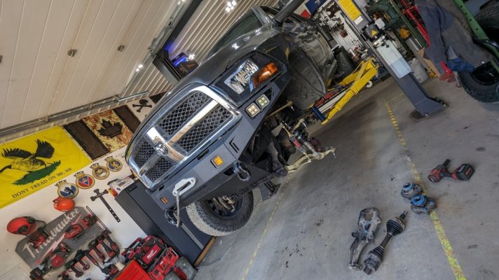

Is there any reason why I shouldn’t cut this off the frame? It annoys me looking at it since I’ve installed the new bumpers.

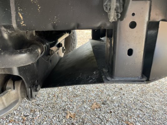

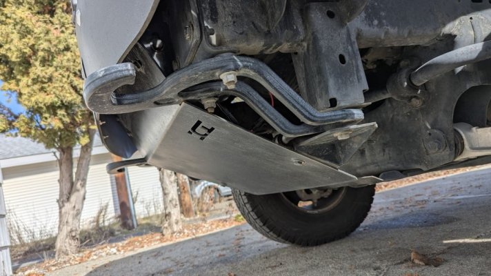

My fab 4's has a bracket that attaches that to the bumper, it is a quasi skid plate by itself, but you can attach a skid plate later if you chose. I guess even if you cut it you can weld something back if you want a skid plate later. It is a good jacking point as well. Other then that, cut it.

This bracket is a perfect fit to your bumper bracket, it is universal, if you want this bracket will work the same on your truck or any truck.

Everything I've seen about it is for crash compatibility to keep yourself and others safer on the roads. It also happens to be where the OEM recovery hooks anchor, the OEM hooks are cast in such a way that they push off of it in a forward collision to maintain the frame crush zone ahead of them. Some aftermarket bumper assemblies utilize those as mounting points.

Just for reference here is a photo of the factory tow hook mounting points (single shear bolts to bumper mounting bracket, rubber slip mount to the bottom of that frame feature) and also of an aftermarket bumper's bash plate use of the same feature as a mounting point.

That makes sense. I didn't have factory tow hooks, and I never noticed them with the OE bumper

i know this post is old. i left mine and tied in my skid plates to them. i left them cuz if/when the day comes that i sell the truck, i want to put back on stock bumper and recovery hooks.
