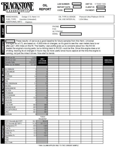

Just an update. Ive been doing some research and I think my #3 exhaust valve is black from a leaking valve seal. I also noticed a puff of blue smoke right at start-up then white exhaust smoke a couple seconds later. The truck is using about 1/2 quart of oil every 900-1000 miles. Changes all plugs, here's a pic of the plugs from cylinders #1 and #3. Not sure with plugs are from which cylinders though sorry.
Thoughts?
