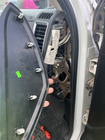

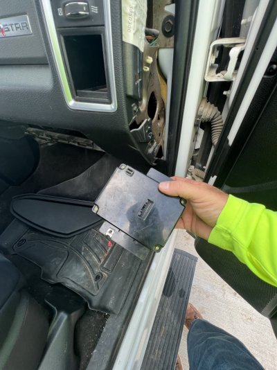

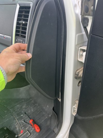

AC control module was the corporate in my situation. Dash cluster stayed on and drained the battery every night.
$180 part!

Thanks for the info. What is this part offically called. I cant seem to find it.
