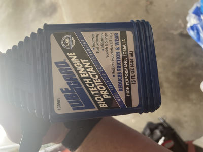

I add a bottle every change. She's been real steady with just the usual startup tick for a few seconds, then smooth as butter.
As I have said many times before I had a really loud tick with Mobil 1 first oil change. 60k miles bought used. It was scary bad. This was back when the tick had just really become a problem. Lots of people voted Mobil 1 in the synthetic oil thread. I too voted at that time. Dig deeper into the issue and read about lubricant issues. I remembered back to the older days and building big blocks with my dad. He’d run pennzoil in everything and Castrol GTX in them. So I read it was spec so I switched. Moved on from a wix filter. Still awesome filter don’t get me wrong. I wasn’t going to fork out redline prices. Married and 5 boys. So I dumped a bottle of sea foam in the crankcase drove 100 miles so it was at like 600 miles at the time. Dumped it and went with edge and the boss filter. Did a lot of research and at the time it was part of oil change special. Went that route and I am currently at 139k and never had the tick again. Not saying that’s everyone’s solution, but that’s something to try that won’t hurt your motor. I’ll report back with if the lube guard helps my MPG. I pulled my PCV valve and I will be replacing that tomorrow.

I am a firm believer in Lubeguard. The last oil change my wife put in Mobile 1 and of course I added the 15oz LG once she got home. The Hemi is still quiet so I will just let it run until the next oil change. The thing is, you can find Mobile 1 everywhere and some other oils can be hard to find. I figure if it is a good synth/blend I can throw in LG and all is good. I do need to start using a better filter though. I put Amsoil in my 2011 300C and after 600 miles the change oil indicator tripped. I reset it and about 500 miles later it tripped again. This repeated for 2000 miles and I finally changed oil and put in M1 and the oil life indicator went back to normal. I have no idea why it behaved that way, but that cured me from using Amsoil again. I know it is not the best but M1 has been real consistant for me in various makes of vehicles we have owned from 1980 until today. Since we have the Max Care 7/100K warranty I will keep the oil at 5w-20 just to keep down any questions if an engine issue arises.

A little two day update. Truck always start a little rough when it sat over night. Yesterday I put about 70 miles on it and started it up this morning. It started very smoothly. Its never started that smooth in the 5 years its been with me.

I know I'm late to this thread but reporting anyway. I just changed my oil to Redline 5w30 and the RP 20-820 filter 2 days ago. My truck is a 2010 Ram (5.7L) I bought new and have had for over 11 years. It just turned 75k miles on the odometer. It's been a great truck with not much maintenance required other than brakes, rotors, and oil changes. I also had to replace a couple of broke exhaust bolts and exhaust gasket a few years ago on one side. I think it's had the startup ticking for 3 or so years now. It just ticks for 20 or 30 seconds and then goes away. I ran acroos the Redline page on here and then these posts about the Lubegard 30901 Bio/Tech Engine Oil Protectant. So I've been running the Redline for a couple of days and it hasn't stopped the ticking so I went ahead and just ordered the Lubegard 30901 Bio/Tech Engine Oil Protectant, 15 oz. I realize I should probably give it up to about 1500 miles with the Redline to give it time to do it's thing. So I may hold off on adding the Lubegard.
Thanks,
Steve
Update: It's been two months and 1800 miles since I changed to the Redline oil and RP filter. About 500 miles after changing to Redline I also added the Lubegard. It still ticks for about 30 seconds on the first startup of the day and any subsequent startups after it's sit for an hour or so.

Thanks for the update. The one thing that is a feature of hemi lifter tick is warm idle tick, does it tick at warm idle like when you come back from any trip you took even to the store? If it does can you possibly vid capture it? If, it never ticks at warm idle, I would look hard at exhaust bolts. Especially if the noise never changed especially at oil changes.

It does do the warm idle tick after a short trip to the store, just not as pronounced. One odd thing I've noticed that helps eliminate it sometimes is if I back in my driveway which is uphill from the road, it doesn't havee any tick when I crank it even after sitting over night. My driveway is very steep, so all of the oil i guess is at the front on the engine when I back in the driveway. Just thought I would mention that.

There have been some guys that help start this deal that found out a full sump helps stop tick. I go 8 quarts in mine, they go 7 and a half. But, since you are on a tilt, I'm not sure if that would be good or bad.
