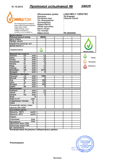

Sorry if I missed it but what is your guys thoughts on Ceratec, especially vs lubegaurd?
Dunno on this one Nick, I can only say it isnt one of the dangerous additives per their msds. Most ceramic additives are really a silicone, just like wax coatings they call ceramic end up being silicone dioxide. If you do a voa on this my guess would be high silicone level, and if they hold true to their philosophy on extreme pressure chemistry it could have titanium as well. Total guesses there, but bottom line it is fairly safe to use. I doubt there is a voa out there, but I'll check a bit. If I dont post it there isnt one I can find.

I dont see uoa, here is 11 pages of BITOG, I'm not sure it would be helpful they way posts tend to go over there. Maybe some chemistry is posted, I'm not that interested in this one, but here it is if you are curious.
