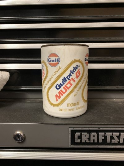

I found a gem rummaging through some stuff I got when my dad passed away back in 1994. I had to keep it as it brought back memories of a fun childhood growing up working at my Dad’s Gulf Service Station. He was a Gulf dealer for 30+ years. Here is a picture of him in 1959. In those days, there were no automatic nozzles. He taught me how to listen to change in sound when the gas was getting near the top of the tank. Of course that can of oil was from a much later time.
