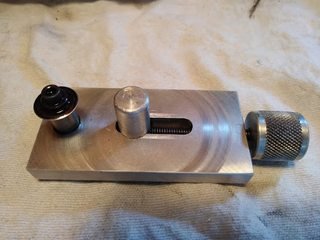

I've had my filter cutter for about 18yrs. Scored it off of eBay back then from a motorcycle shop. It can handle all but really big filtes. I have yet to find a filter with blown out media, rips, holes, etc. Even the dreaded fiber end cap cheapos.

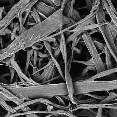

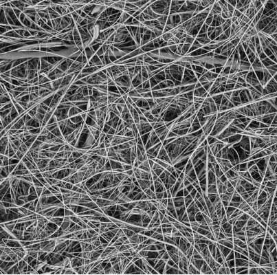

This is why spun microglass both filters better and has better flow. Same magnification, one paper one microglass. Larger holes inbetween paper surface, and larger paper surface. Then add the fact that you have to add binders to paper to get them to bind, and those binders turn into card paper like substance with heat cycles as proven by every paper filter I ever cut open with a long interval, every single one. When that paper is stiff, it isn't filtering anything, usually there are wide gaps the oil goes through if not full bypass.
However, the spun microglass stays pliable and smooth day one to day 2 year+ as proven in syn thread, they simply never degrade, the never bind the way paper filters do. When it comes to filtering bypass is number one, spun microglass is number 2, paper belongs on a toilet roll.
Is bypass worth it in a hemi? Maybe, maybe not, up to personal choice.

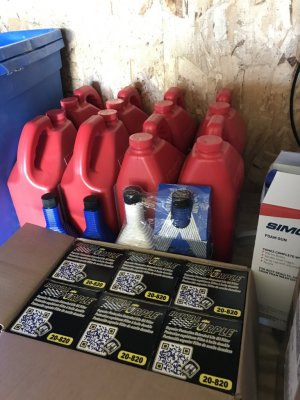

That being said, nobody has mentioned Wix in this thread..... however, Royal Purple is brought up more than several times..... whats up with that?
Read oil filter thread, the reason the RP is so popular just a thick loose media. The only downside to wix xp is it didn't make it into the gm test, I wish it had. The choice between the two seam to be a thin tight media or a thick loose media, I guess you can make an argument for either. My deal is all of the spun microglass are the top filters for sure.
It would be nice if shrm bird try adding something to these threads, at least acknowledge the ram forum members who have tested these products and reported their findings.
These arent 20-820 which I believe has more holes.
I tried both wix xp and rp in other vehicles, wix xp tight thin media compared to rp.
