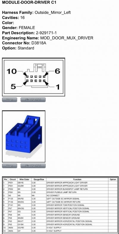

There's a schematic in the power fold thread you can use to check the mirror pins at the module...
are post here.

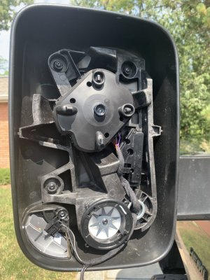

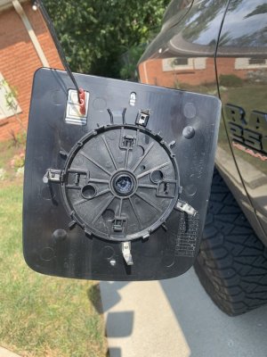

Only 2 wires connected directly to the glass
Dang it. And nothing attached on the other of the glass?

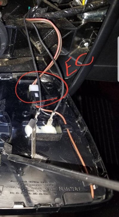

@CincyCuda68
here's what the AutoDim EC connector looks like on the back of the Regular Power fold mirrors.
Q: you're sure you don't have anything extra behind there?

Crap that video shows only removal of the small glass.
But the big glass comes out the same way. Pop the small mirror off then pop the large mirror.
No go on the autodim for the black memory tow mirrors with heat and powerfold.

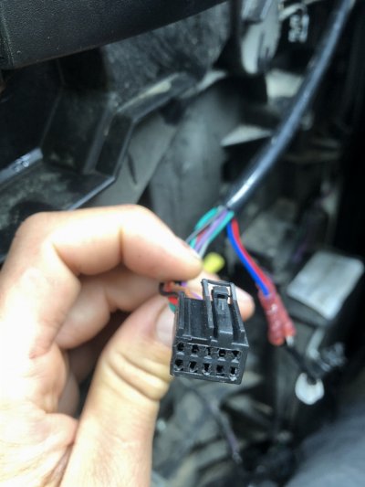

I have purchased a set of power mirrors with puddle light and signal led.
They are installed in a 2014 Tradesman with manual locks/windows.
I have no door modules. I am looking to get 12v to the LED and the puddle lights but I need a pin out for this connector. I have scoured the web and several forum posts but no luck.
Can anyone help me out?
stihlyourface
Apr 10, 2019
37
Connecticut
6.4L Hemi
You are awesome Jimmy!
I’ll let you guys know how I make out.
Does anyone know if these lights will take a full 12v, I see some of the pins are 5v
