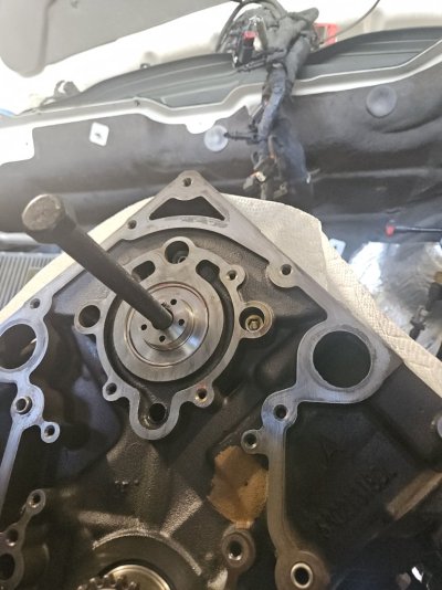

Cam is in.
So glad I had a harmonic balancer install kit, it had a stud with 12 x 1.75 threads to put in place of the cam bolt.
Was kind of a pain in the balls to get it lined up just so, but the longer stud from the balancer kit was long enough to get leverage on the cam to line it up.

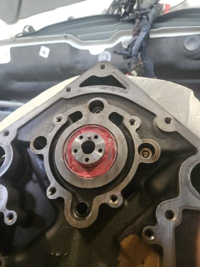

The Red Line assembly lube was thinner than I expected, was expecting a grease consistency. Didn't take very much, glad I didn't get the pint container.....lol.
Assembly lube on the cam surface for the thrust plate install.

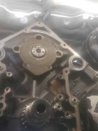

Cam thrust plate in and torqued.

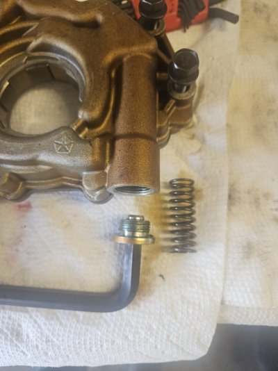

Removed stock oil pump relief spring:20250901_113722.jpg
Next to Hellcat relief spring, Hellcat relief spring is larger wire and longer:

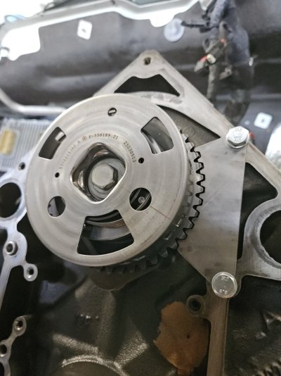

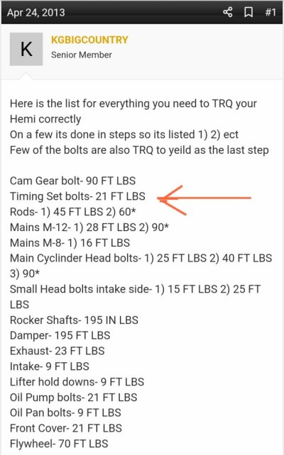

I did get the cam phaser torqued. @Ken226, that ebay tool is the shi-znit!
Well, gotta stop here, broke a bolt on timing chain guide, the first post sticky thread says 21 ft-lbs.
I was thinking that was alot for a 6mm bolt, and it was.
UPDATE: ACCORDING TO THE FSM, TORQUE ON TIMING SET BOLTS IS 8 FT-LBS. (96 IN-LBS.)
Lucky it broke away from the block and not inside or flush.
Gotta get a couple bolts from dealer now.

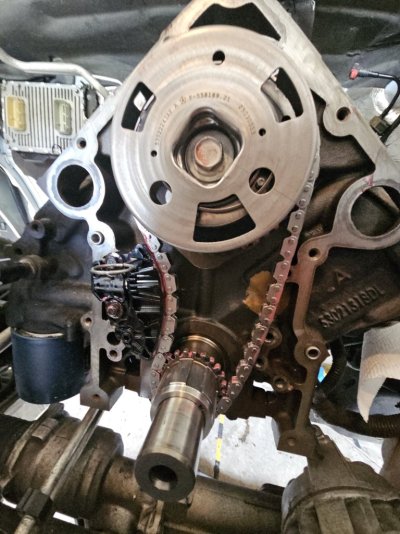

Here's where I left it:
Gonna give the chain a dose of assembly lube once the guide and tensioner are set.

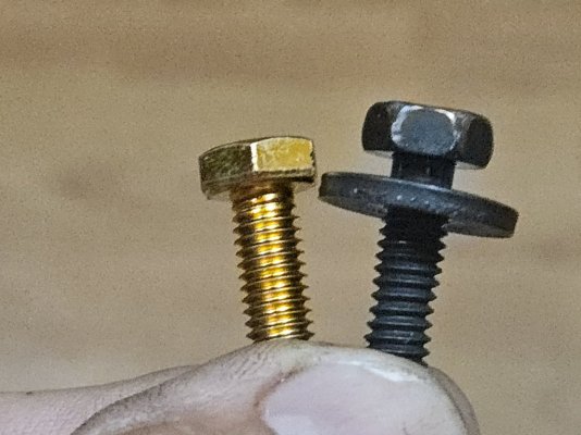

Picked up a pack of Dorman grade 10.9 bolts in 6 x 1.0mm x 30mm long. I will have to transfer over the coned washers.

Does anyone have the torque values for the timing chain tensioner and guide bolts?
As near as I can tell the 9.8 bolts have a maximum tightening torque of 9.82 ft-lbs. (117 in-lbs.) The 10 9 bolts have a max of 12.5 ft-lbs. (150 in-lbs.).
I'm thinking I should be good at 9 - 9.5 ft-lbs. (108 - 114 in-lbs.). Thoughts?
The difference between the originals (aside from head height) is they have an unthreaded part under the head where the cone washer sits.
I can transfer the cone washer to the new bolts, might have to open up the ID of the washer a little.
Do you think I will be ok, or am I better off with OE bolts here?
They are not expensive, 2 OE bolts probably cost a little more than the pack of 6 Dorman bolts I bought.
By all rights, it should be ok, but once I close it up, I am comitted (and I just might be committed by the time I get done.....lol)

Nit picker! :)
Yep, I'm gonna need that rubber room with no corners.....lol.
I will call the local dealer tomorrow about the OE bolts. I went this far with all OE parts, makes me nervous to use something else here, especially now.
I'm looking for the factory torque specs now.
