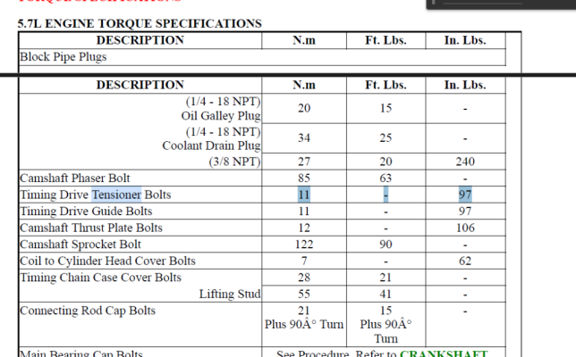

Does anyone have the torque values for the timing chain tensioner and guide bolts?
As near as I can tell the 9.8 bolts have a maximum tightening torque of 9.82 ft-lbs. (117 in-lbs.) The 10 9 bolts have a max of 12.5 ft-lbs. (150 in-lbs.).
I'm thinking I should be good at 9 - 9.5 ft-lbs. (108 - 114 in-lbs.). Thoughts?

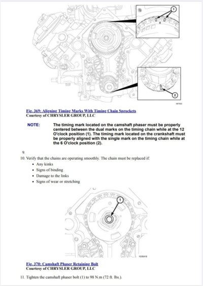

From my factory service manual:
Jan 17, 2016
23,819
54,829
14 Sport
Thank you, Ken.
I found it at almost the same time. Only 8 ft-lbs
It even says tighten the camshaft bolt to 72 ft-lbs.
I tightened mine to 90 ft-lbs.
90 is the proper torque on the phazor Ed. There's a pile of differant torque specs listed on differant bulletins,sometimes you gotta guess and use common sense when figuring out what's the proper torque,it also doesn't hurt to look up the actual bolt torque specs when you run into a bulletin telling you a suspect bolt torque,aka a 6 mm bolt with a 21 ft-lb spec. Other then head bolts and cam bolts i just tighten them by hand,as i trust my feel more then i trust alot of bolt torque specs

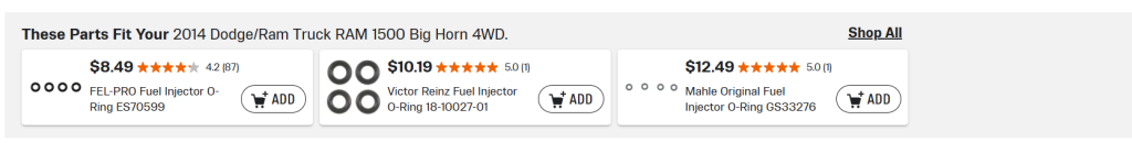

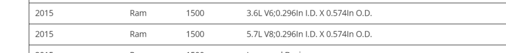

Question #642:
Recommendations on fuel injector o-rings?
Ma Mopar is smoking some good sh*t!!!!
Ken226
Mar 12, 2017
2,305
5,970
Washington State
Also, did a search for the FelPro part# ES70599 from AutoZone, on google, and got this from Amazon. Shows for a F150, but as long as they are the same size and part#.
The ones on Amazon show "Ram" under compatibility:
EdGs
EdGs
Nov 29, 2020
5,561
11,804
FL
Thank you @Ken226. Opted for the FelPro. Got 4 sets to cover 2 for each injector. I could swear the original rings appeared to be two different sizes, but won't be surprised if not. Might just be the way they fit.

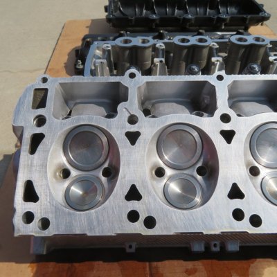

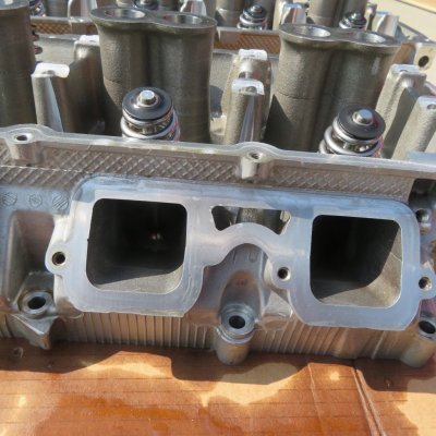

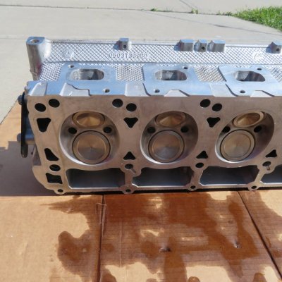

You're gonna be proud Ed,finally got around to taking some pic's of the heads today,lol.
We're stalled for now waiting on headers,so we didn't get the heads cleaned up till today.
Just so you know,i was mumbling under my breath " That Damn Ed,he's making me do more work then i normally do,trying to keep up to him" :Big Laugh: :Big Laugh: :Big Laugh:
Yeah, but my trucks been down for a few months....lol
So, you're leaps and bounds ahead of me, Rick.
