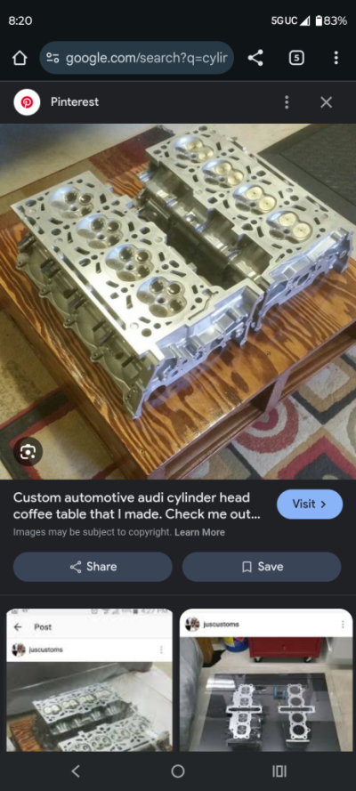

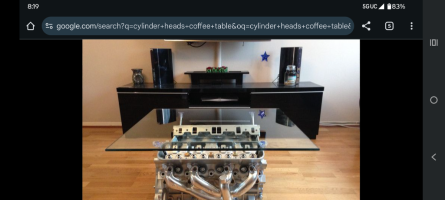

Damn. That's pretty.
Those would make a beautiful coffee table.
Edit: yea, like these
View attachment 572564View attachment 572565
When I was 15, I was visiting my Brother in Detroit, who worked at a dealership body shop. One day, he took me to a buddies house, the guy had a complete 402 rat motor, sitting on a coffee table in all it's glory. He had a hood hanging on the wall with an airbushed naked lady on it, etc.
