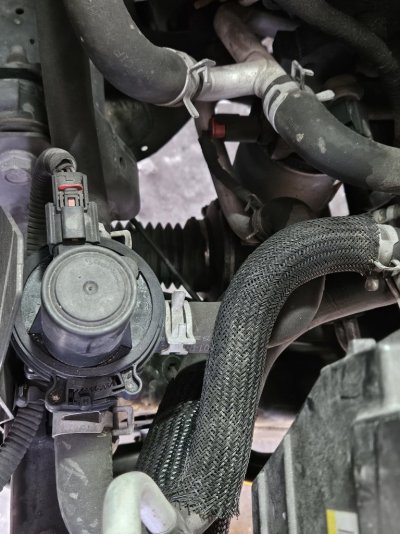

I have these pics of my 3way valve and hoses, 20250118_115427.jpg20250118_120138.jpg
So am i correct that one of the hoses goes to the black metal pipe below the hose marked in blue.
Does the other go to the silver tee to the left of the blue marked hose, or to the water pump where the blue marked hose is connected?
Sorry, I am a bit brain-dead......lol

If you're converting back to earlier style 5/6 speed hoses,the "T" will go away,and that hose should go to the top heater core outlet,and the lower outlet hose from the heater core will go to the black pipe

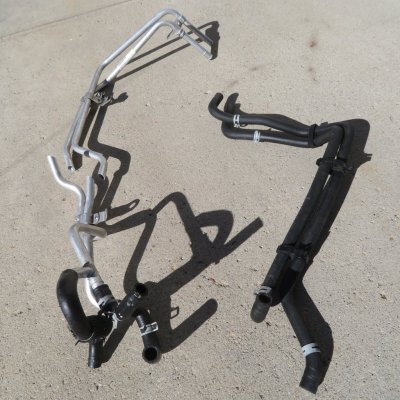

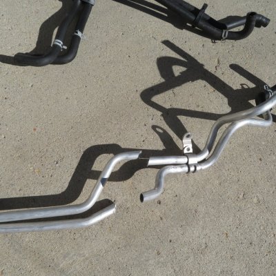

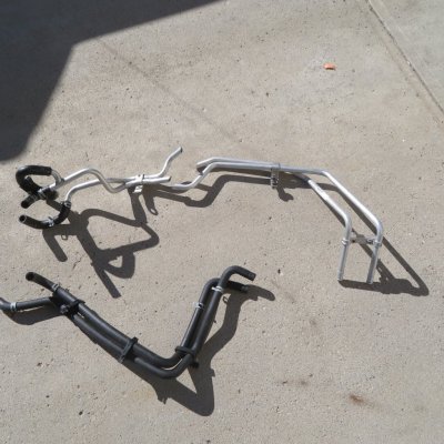

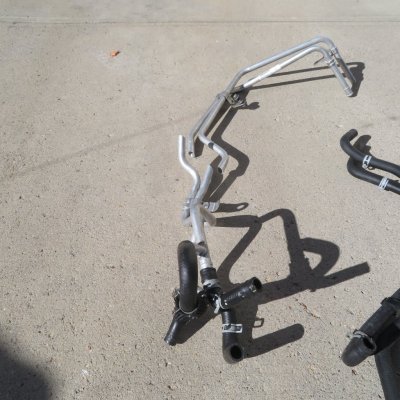

This is the mess you can get rid of,if you wanted to cut the steel lines,lol.
I'd send you all my old hoses/lines if you were closer,as they're fairly low milege,and still in really good shape ;)
