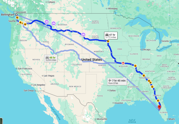

But yea, as much as I like Florida, it's a bit of a haul. I'm not sure my ass could handle that many hours sitting in a truck seat. :)
I don't think there are many points in the US that are further apart. Excluding Alaska and Hawaii.

Well, you could fly. Hell, I'd fly you in if I could afford it.
You got the destination as Tampa, I'm about 2-1/2 hours south of there, almost directly west of Lake Okeechobee, probably 20 minutes by air.
RSW is about 20 minutes from my house.
