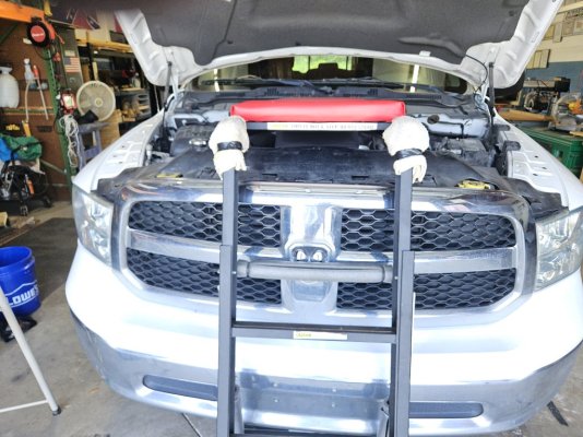

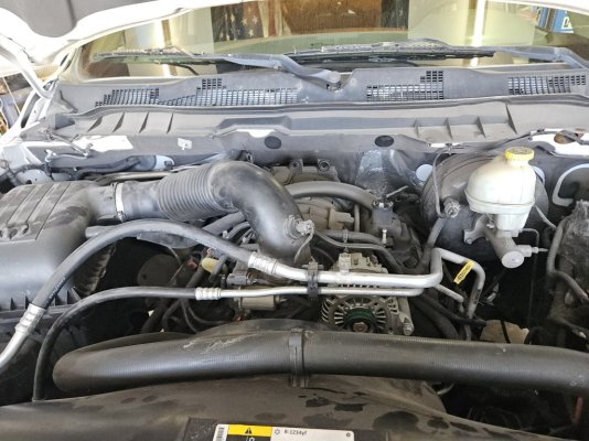

Ready to start. Engine cover off.
No engine codes.
When I put the stethascope near the #5 coilpack, I can hear the intermittet tap, lightly. Cannot get near #7 from the ground, topside creeper at the ready:
