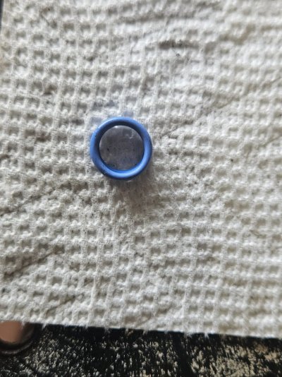

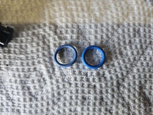

Ok, the o-rings are pretty much identical in size.
New ring on right:
It appears the new one is thicker, but the original is misshapen, IMO.
Old ring on top of new:

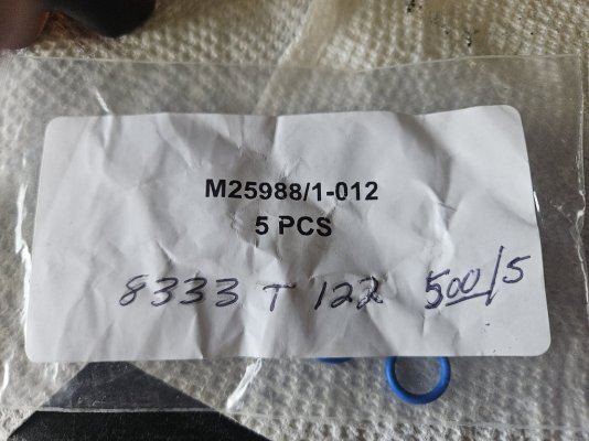

It is a McMaster-Carr part # 8333T122
Fluorosilicone, 012 dash number, .070 thick, .364 ID, .504 OD, temp rating -75° to 390°
$5.00 per pack of 5
The map sensor feels firm in the mount with the new ring. I guess I am the guinea pig, use at your own risk.

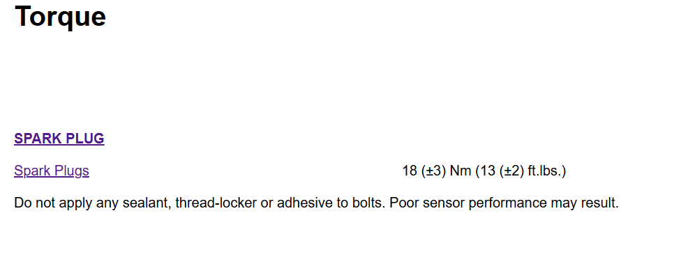

Anyone know the torque value for the spark plugs in the Hemi? I installed the rear plugs on all cylinders, but I can't seem to find the spec on it.
Saw one place on the net that said do no exceed 15 ft-lbs, saw another that said 20 ft-lbs.
Looked through the manual and don't see it listed, but I could've been staring right at it.
Thanks.

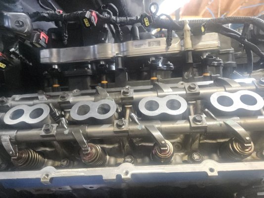

Primed the engine with oil, put 6-1/2 qts in through the block plug. Lost a little unhooking my apparatus.
Had good oil at the rockers, but didn't seem as much at the intake springs. There was plenty running out the rocker arms and shaft.

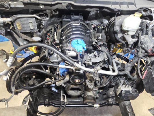

Yeah, I didn't have any reducers on hand, so I just bought a 3 foot length of 5/8" heater hose and used about 2 feet to put a more gentle loop in the hose. Clamped with 2 of the MU23 clamps from the original hoses.
As far as progress, got the valve covers on, all spark plugs in. Passenger side wiring harness connected at all engine points, as far as I can tell. Fuel line reconnected at rail.
You can see my heater hose bypass loop on left side:
Coils are not installed yet, the boots don't want to come off the coils.
I couldn't find the torque specs for the plugs, one place said no more than 15 ft-lbs., so that's what I used til I know for sure.

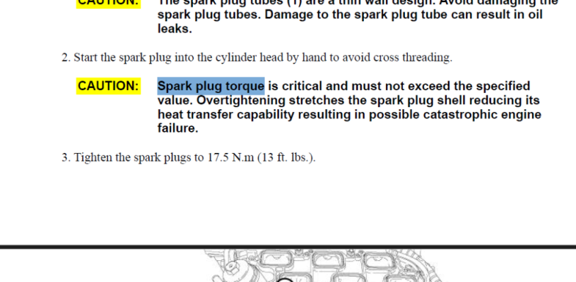

I checked my service manual. It says:
Our Durango R/T also calls for 13ft lbs
Gonna do a video of the first engine start?
Double check those intake ports for forgotten shop towels!
