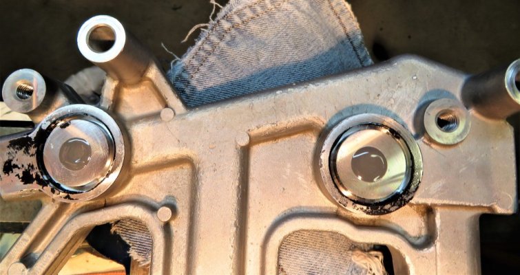

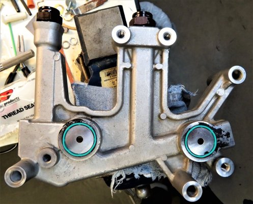

I used a shopvac to suck the coolant from the TMU lines, I got a little less than a quart out. Coolant appeared to be only in the bottom line.
Do I still need to blow them out with compressed air?
If so, how much psi? 15 psi, since rad cap is 16?
Do I need to loop the TMU lines together where the coolant hoses attach to the TMU?
I can then leave the TMU as is, right?
Gonna install my @caulk04 bypass and aluminum cap as well
Jan 17, 2016
23,853
54,910
14 Sport
You can blow them out with upwards of 25 psi if you want,but if you sucked them dry,you should be good to go. You can remove the TMU,JB Weld a couple plugs into the holes and then loop the hoses together on top of the transmission using a plastic Dorman heater hose coupling.If you go back to the earlier molded heater hoses,then you don't have to loop the hoses together on top of the transmission,as there'll be no coolant fed to them. If you delete the TMU you'll never have to worry about the TMU leaking coolant into the transmission,the transmission will take a little longer to get up to temp,but remember the cars and heavy duty trucks don't heat the transmission fluid,so the TMU isn't something you really need. To bad the 1500's thermostat wasn't like the 2500's thermostat,as the 2500's and heavier with the 8 speed run about 20 degrees cooler then the 8 speeds in the 1500's do.
These are the holes that need to be plugged if you remove the TMU,it's all in the Revmax thread starting about pg24
