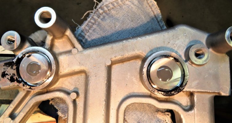

Regarding deleting the TMU, does anyone know the size of the holes befor tapping for the 5/16-18 set screw?
Was thinking about tapping it for a 1/16 NPT pipe plug. That way, no JB Weld needed, just thread sealant.
Jan 17, 2016
23,875
54,968
14 Sport
Just run a 5/16's tap into the holes Ed as i don't remember drilling it,just tapping it. You could use thread sealant i only used JB Weld as i knew i'd never be sticking the TMU back on the transmission
Ken226
Mar 12, 2017
2,318
6,011
Washington State
I'm not exactly sure what you're talking about, but it sounds a little bit like your tapping threads into the transmission case? Or maybe into the TMU itself?
If so, unless there is alot of material around the hole to support it, I'd avoid a NPT thread/fitting. Take Rick's advice and just go with standard 5/16-18 threads.
NPT threads accept tapered plugs/fittings. The taper seals good, but the taper puts quite a bit of radial force on the threaded hole. In cast aluminum without alot of material around the hole, a NPT fitting stands a good risk of cracking the case.
In something that sees alot of heat cycling, i'd be reluctant to risk it.
If your luck is anything like mine, and I have **** luck, and it would probably last just long enough to get you out into the middle of the desert in Utah or New Mexico, while towing a trailer and with a woman and 2 dogs in the car before it lets go:
I looked up this mod on youtube, and those look particularly susceptible, due to the thin wall around that hole. I wouldn't if i was you. It looks like the effective wall thickness from the root of the NPT thread to the OD of the **** would be pretty thin.
EdGs
EdGs
Nov 29, 2020
5,609
11,897
FL
The 1/16 NPT (1/16-27) is very close in size to a 5/16-18, and the tapered thread would be a plus, IMO.
5/16-18 uses a .257 tap drill, 1/16 uses a "C" drill (.242) I've used a 1/4" bit before with aluminum. I have both taps and 1/16 plugs too, I just wasn't sure what the size of the hole started out at.

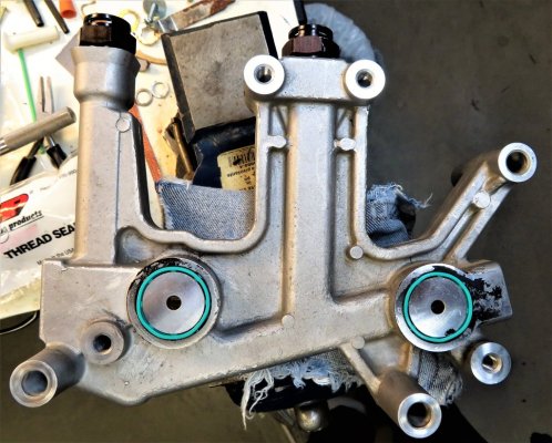

I'm talking about the 2 holes with the green o-rings in the photo. Those are the ones I'm supposed to tap, right?
(Photo borrowed from the revmax thread)
Or am I talking about just deleting the heat exchanger?
Those are holes you want to tap,you could just as easily tap them for a NPT plug if you feel more comfortable using a pipe plug Ed. It's your call,i just used a 5/16's set screw as i have a bunch of them in various sizes,i also have a bunch of NPT plugs to,i never even really thought about using a pipe plug though,as when i was grabbing taps to thread the holes and found a 5/16's tap was just about the perfect size,i quit looking for other plugs,lol
