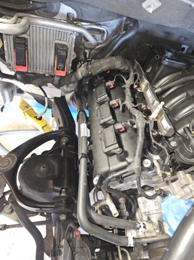

Passenger side wiring connected, coils attached. I have the Pulsar module (thank you, @JHoward), that will get installed after she's up and running.
She'll look even better once I remove those transmission heat exchanger lines.

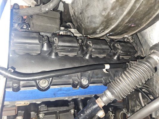

Driver side coils installed, all vapor and vacuum lines connected.20251030_183901.jpg

Looking good Ed.If you had anything electrical bolted to the back of the heads,make sure you don't forget to reconnect it,alot of guys forget to reconnect the stuff that attaches to the back of the heads
Thank you.
The only electrical on the back of the heads was a ground on the driver side head and the SRV actuator and MAP sensor. Those got reconnected first.
There is a routing clip attached to the rear driver side head, I dont think I slipped it's counterpart back onto it.
