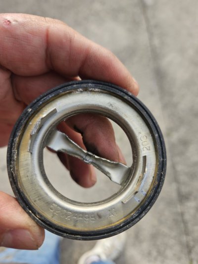

Yes, tested on stove, it began opening in the mid-190's seemed full open by 205°, and closed again in the mid-190's.
I have my original 203° that I took the guts out of.....lol20250324_180251.jpg

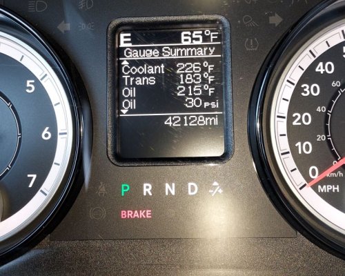

At least your temp doesn't look like mine did while driving in a small town last week. It also went from 194 to 228 in less than 4 minutes when I had to take a detour up a very steep and crooked road the day before.
It will run 194-196 all day long until a steep climb at low speed or in town. At 228 it will start cooling down some.
How any company can think fast rise and fall of temps don't hurt an engine. Stupid people.

If it acts up again,i'd go back to the gutted original,it's not like it gets cold in Florida :Big Laugh: :Big Laugh:
Isn't that basically just a restrictor plate, then?
I'd actually like to have constant circulation anyway, then I know it can never stick closed.

Wonder if I should just make one. We have a machine shop at my work, and plenty of 6061 aluminum. As far as gaskets go I have 2 old thermostats, or could buy new ones.
