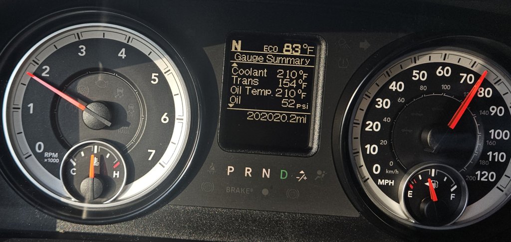

I will have to extend my interval a bit before I switch to the RedLine 5W-30, I will likely be ~1000 miles on this SuperTech 5W-30 conventional. Oil is still very clean (God, I hope so after what I've been through, lol)
Pressures are good as well (at least good to me), I hit a repeating mileage number earlier:

On my way to work, at full hot, coolant temp was 203°, oil temp was 212°, my oil pressure at 600 rpm idle was 47psi, 3-5 psi higher than the SuperTech 5W-30.
Running at ~1750 rpm, oil pressure was 53 psi, about 3 psi higher than the Supertech 5W-30.
I like these numbers. Alot.

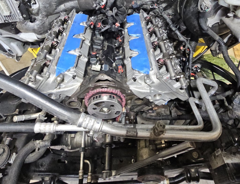

That's why I used the painter's tape to cover my intake and exhaust ports after I was done cleaning the heads.
