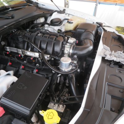

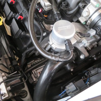

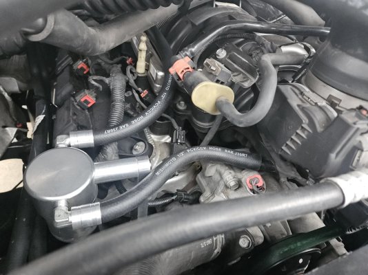

I ordered a length of Mishimoto catch can hose and had it delivered here to NC, and got it installed. It fit the aluminum hose ends very well, and looks like it will hold up well

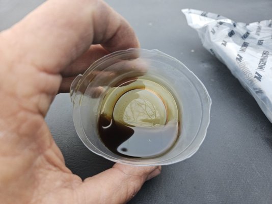

I drained the catch can that has 1161 miles on it, and this is what drained out, maybe 1oz?
Very pleased so far. Thank you, @JHoward.

Yep, that looks like about the amount I would get at ~ 3000 mile oci's.

I'm by no means an expert and I have been wrong on a number of occasions and I didn't sleep at a holiday inn express last night, but are you certain you have the hoses on your catch can routed correctly. Maybe it doesn't matter but I have seen them routed pcv valve to front port and back.port to adapter under intake.
I got two of these things, 1 on my 14 RT that is supercharged and 1 on my 24 that has got 15k on it. Both will damn near fill that type of catch can up in 3k miles. I run UPR cans and have for years. I Empty them at least one time between OCI and I'm a 5k OCI guy, running redline 5w30.
Just asking, Don't mean to be questioning or causing trouble. Maybe there is no right or wrong way. But I would have expected more in the catch can than your picture noted.
I'm happy to be wrong and defer to your expertise or instructions if you got them with the can.
Hoping I'm wrong
Hoping I'm wrong

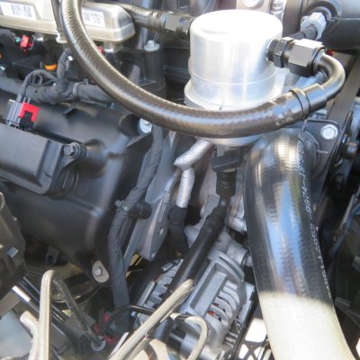

Actually, your routing looks cleaner like that. The baffle inside of mine can be installed either way.
No instructions with the can, but there's really not much to them. I can use all the help I can get. The only knowldge and experience I have with my Hemi comes from right here.
Don't ever apologize for pointing something out that does not look right. I welcome the input and comments.
I do have the line from the pcv going through the strainer media. I hope that is the correct way.
I will likely switch them around to match yours (and the strainer media, too). Looks much better, IMO.
If I've done something wrong, it won't be the first time.....lol.

You've done such a good job, and very throughly I might add, I hated to even mention it, but it looked odd, like I said, I'm not an expert but if it could make a difference I wanted to mention.

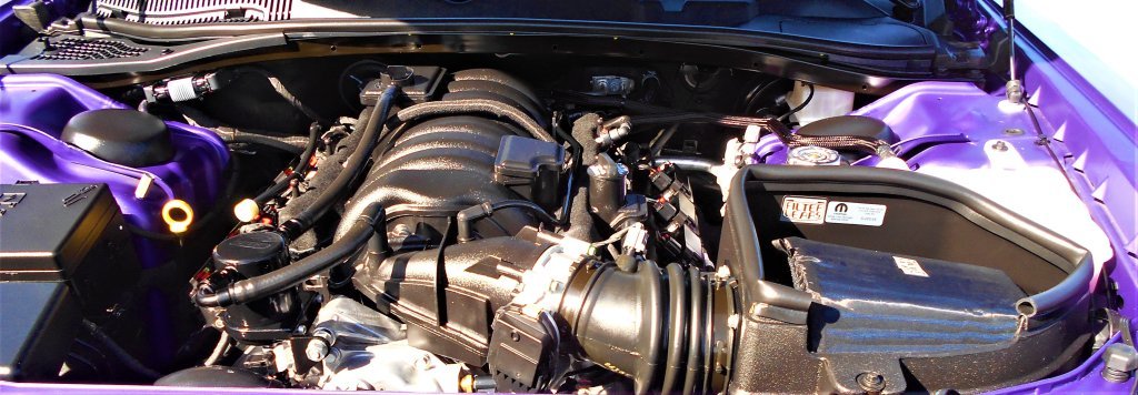

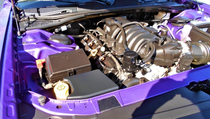

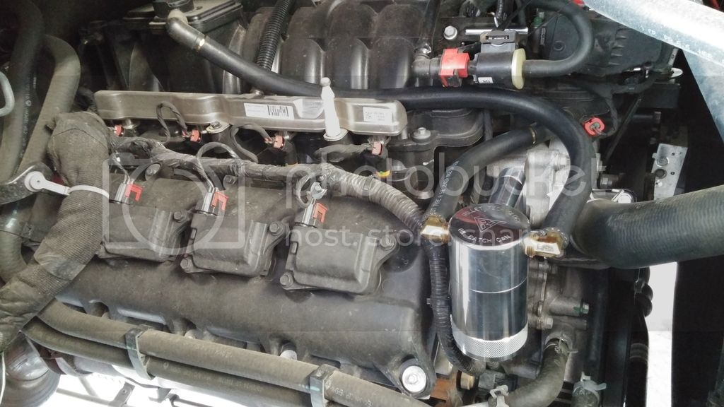

I'd dump the 90's and the shorter the hoses the better.
The way i ran the hoses on the Challenger and 300,i don't have any good pics of the trucks hose routing,but it utilized the same high flow fittings
Thanks for considering
I came here to learn. I had ZERO experience with my Hemi, and not a whole lot more engine experience than that.
No way could I do the work on my engine without all the instruction, support, and encouragement from all of you.
That is why this site is so good, All of you make it so.
Yep, the routing of the oil catch can hoses are as @Bigskyroadglide has depicted in his pic. ...or rather, that is how I installed the hoses on the catch cans, of the brand I gave you, were shown in the "constructions"(as my young nephew would say) ...
I'm sure it makes a difference as you want what's coming from out of the PVC vapors to be caught in the can and the clean/return vapors out to the "throttle body"...
