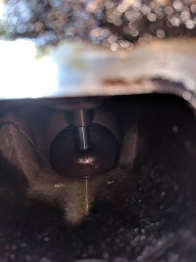

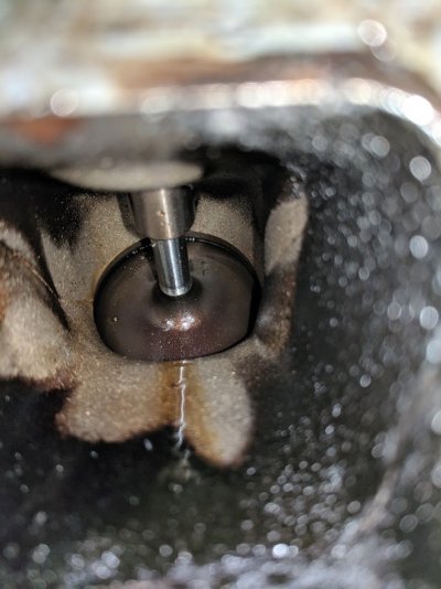

Here are pictures of my intake valves while doing the lifters this past weekend. The truck is a 2011 1500 with 95k miles.
I was kinda shocked at how clean the valves were. I dont run high octane fuel all the time but I do use Lucas additive every 6 months or whenever I can remember.
And after I cleaned the runners with carb cleaner and a scrotch brite pad.

You would expect them to be clean being port injected. Octane has nothing to do with cleaning the intake valves. The gas being injected acts as a solvent.
