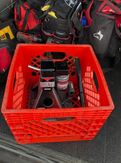

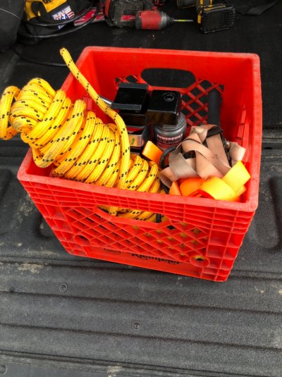

I like that idea, but that reminds me that I have to go out and check mine again, I like fluid film for this stuff. The jack idea is good but where to put it?, but looks like you already have box full, good brand
