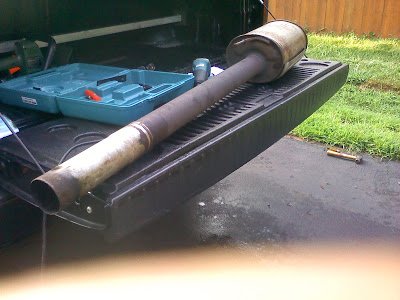

Time for some action, e-cut out due today, here is some preliminary work.
