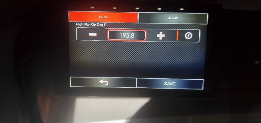

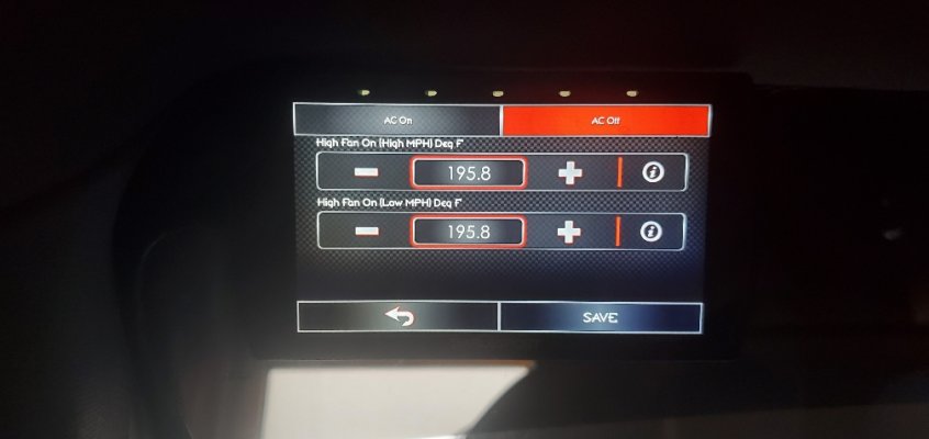

Here's the Fan setpoints in my tuner, FWIW. The Only Fan config I Can find anywhere.
Memory was kinda close but was way wrong. All temps set 195, I think thats correct Yeah?
"High Fan on", I guess they've refferring to my
